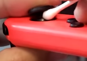

We are not inventing the wheel here. These steps have been discussed all over the internet since problem started few years ago. I am creating this thread after i was asked many times about it on discord. I do not see any thread talking about this so...
Side story: I go up and down on firmware few times a month . (for testing purposes 9.x.x and 10.x.x) oddly enough I started having pretty bad drift issues after downgrading from 10.0.4. then someone reported they had it after updating from 9.x.x. So is it a software issue ? ( i doubt it )
the thing is, it could be many reasons. so we will try all steps in order to eliminate all possible reasons.
I did step one and two, and not only did it fix my drift issue but also they seem a bit more responsive.
Do you have any other way to fix it? do you want to help your fellas comment below.

I think the only true fix is to do a bit of diy on your original joycons I've done it myself bought a couple of analog sticks and a pair of metal catches killing to birds with one stone only cost £15 uk pounds and half an hour of my time no more joycon drifted and a nice firm click when reseating joycons on the switch
It's a very easy job no need to take any brave pills
But as my man dorianx12 says sometimes they just need a good clean or you can ever try going into your settings and recalibrate them

The only two things you really need to be careful are dont bend the ribbon cables to much and if your planning on replacing the catches be careful as the springs are tiny just take your time and your be fine
