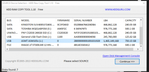

Step 1 A. Take out your PS4 hdd and put it into the HDD reader and connect to your PC
Step 1 B. Choose your PS4 HDD (you can find this looking at the HDD sticker on the outside)
it will find all disks regardless of format

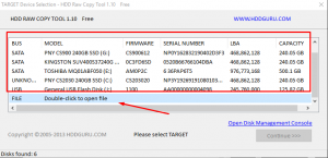

Step 2. select to save as image or Select TARGET HDD

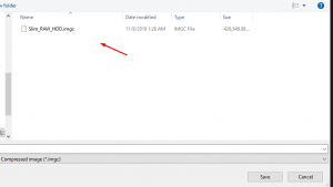

Step 2 A select where you want to save the HDD RAW Image for backup

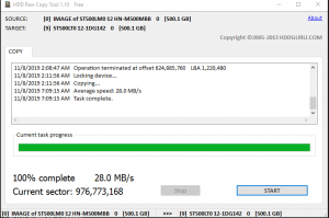

Step 3. Read or Write (depending on what you are doing)
Step 4. Congrats on the New HDD Copy

Q. i got a few errors running it
A. these are normal most of the time and shouldnt effect it, test to be sure
Q. it says Terminated at Offset xxxxxx
A. restart it again from the beginning
